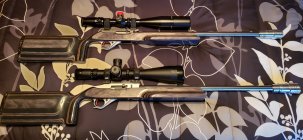

I also have two rimfire benchrest bolt action rifle's. One is made with a Turbo action and the other is made with a 2500x action. Both have a Shilen ratchet barrels. Last weekend I went to the range with some new lupua midas+ ammo and was able to shoot a 5 shot group of .037 with the 2500x rifle. The other rifle doesn't like that ammo. Once you get your rifle built you will have to find ammo your barrel likes. You will find that is the biggest challenge in rimfire. If you find a lot# of ammo your rifle likes you better get as much of it as possible. It seems the rifle is the easy part of rimfire benchrest. Feeding the ammo it likes is another story!!!
That is a FANTASTIC group. At what yardage was that fired at? I can assume it was the standard 50 yards, but I'd like to read what was actual.

I shoot at 50 yards with the rimfires. That rifle has not done to well with any of the lots of ammo that I have. I have several different lots in eley 10x lupua center x and midas+. Although with the new ammo i had just got it really likes it and does shoot pretty consistent with it. I was not posting to brag about the group I didn't even shoot it my girlfriend did. I was just trying to show how different barrels like different ammo. That has been true with all four of my rimfire benchrest rifle's. It was a pretty amazing group though and I made sure she understood what she did.
