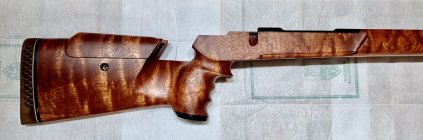

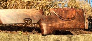

In the past, I’ve made my versions on the heavier side. They’re just a design take off of the discontinued Tikka Master Sporter stock. They can be made smaller and lighter if so desired. I hope to find time this summer to make some lighter versions for some barreled actions I have. My memory is a little foggy on the weight of an original but I think it was under 3 pounds. I made a direct copy for Dusty, a few years ago. Maybe he weighed it and can chime in.
