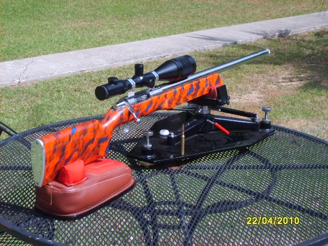

Roninflag,
Those prices might vary a little throughout the country. They are pretty close to what my Smith Charges (Leonard Baity).
The Rifle + 42x NF BR in this picture Cost $4,350.00 w/ Baity’s Muzzle Break that is not on the barrel at the time of the picture.

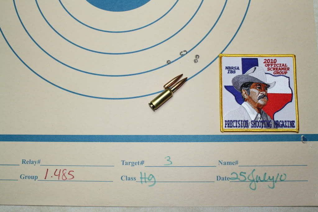

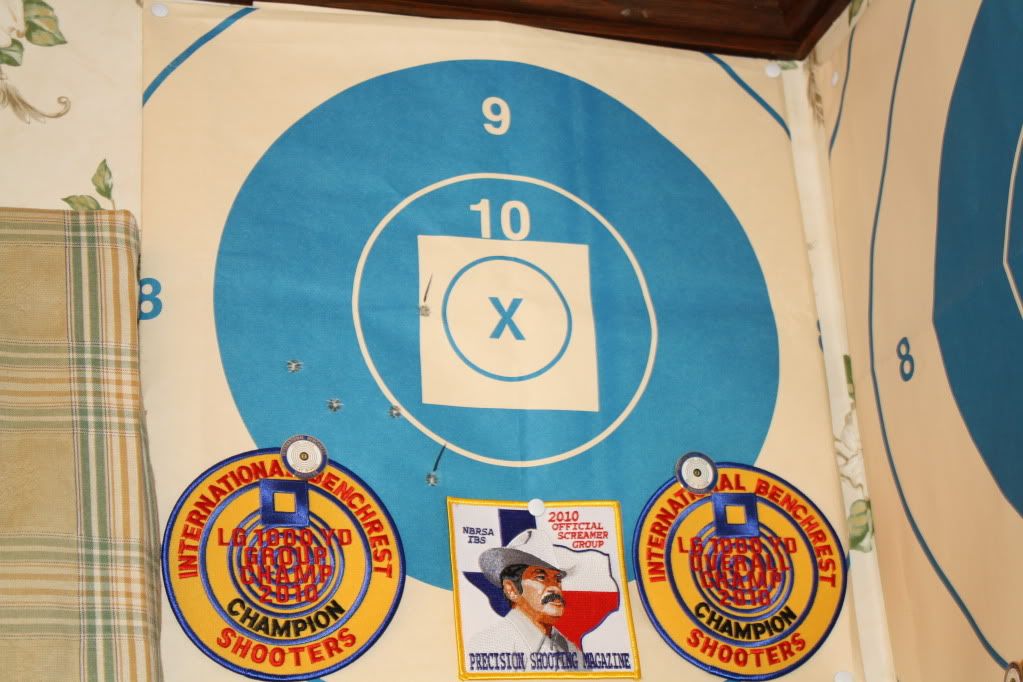

Here is some Accuracy Validation for Ya!
