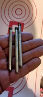

These are the ones I use I got from my local ace hardware . After cutting head off trimming down threads and rounding one side. They work great.
Thats what I was after and attempted it with the only size I could find. 2". I couldn't grab them from the bottom after installation so I baled and went and found the all-thread.
