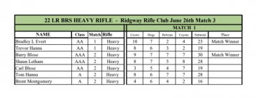

I shot both matches they've had, and what a blast! I think we had around 60 guns the first match. Just had a match this past Saturday. My guess is it's gonna to catch on pretty quick. With the current format, they can fit 160 guns. Those targets are tiny! I've been shooting the 1000 yard VBR version for the past 10 years and the 22LRBR version is awesome. No reloading and doesn't take your entire day up. It's a definite recommend for anyone with a .22. It's an ammo game for sure, as with any .22 sport.
I would say any gun over the "Standard Class" weight of 10lb 2oz would be "Heavy".
Since April was the first match, they shrunk the targets and came up with some new rules, but haven't updated the website. They added the Heavy class so guys with benchrest guns could come shoot it as well. I'm not aware of the other specs other than "heavier" than Standard class, i.e. forearm width, etc.. Contact the email in the rules pdf and they'll let you know any other specifics, but I don't think they want to turn anyone away, b/c the gun doesn't fit. I believe that may be a catch-all class then

They are running 4 match time slots currently, with 10 benches and 4 relays (potential for 40 shooters per match). You shoot all 40 targets in about 20 minutes and reset your targets for the relay after you. So basically you can be done in less than 2 hrs, after target setting and scoring next relay obligations.

Other than standard smallbore rules for gun specs., you can opt to use their sandbag or attached bipod. Bipod does not count as rifle weight. No rear support bag, only hand and shoulder contact and stock must not touch bench. Other than that, you just show up and have fun!

Vudoo in the Ridgeback may be fine, just don't extend the cheekpiece, and as long as the forearm isn't more than 2.25"?
Same way with the Kidd 10/22. I saw a few 10/22's there. I think they are more concerned about the cheek part of the stock vs the bottom. Of course I'm not sure how to interpret the NRA stock rules, as long as the bottom of the stock (butt-plate) doesn't extend below (like a hook?) Those tactical or training stock's like a M4A or M5, etc that have the scoop for a rear bag, I believe to be ok. Remember you're supporting the rear of the stock with your shoulder/hand. Again, ask Anthony in the email, but they are pretty lenient as long as you don't have something that is giving you a clear advantage. The dang targets are small enough as it is, and I don't see many people running the course with clean 40's any time soon, so it's more about getting people to come now.
Your 2500x would probably fall under Heavy gun...
I'm sure you can bring any or all of them, you may even be able to shoot multiple gun classes, like Standard and Heavy with your current setups
