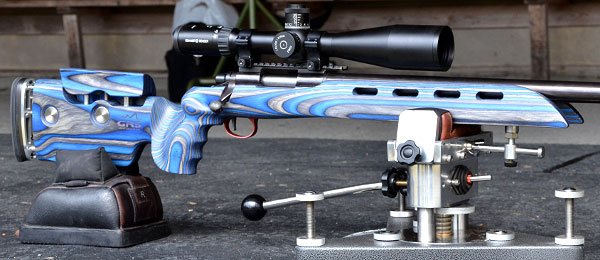

Hi Guys ,
thanks for your input, I live in Glasgow Scotland and have had dealings with this company,I ordered a tactical inletted for a browning long action,I have a Eurobolt,no problems with inletting furniture fitted ok , unfortunately they sent me a ruger stock the first time ,I contacted them and was sent the correct stock which in fact required little work done to it,I waited three months for the wrong stock and a further two for the correct one,since then I have had a 28'' Border Barrel fitted to my action the stock pillar bedded and crafted, I have mixed feelings as to Microfit Stocks, they did cock up the first time but made every effort to correct it,judge for yourselves , with a little effort this is how it turned out after I oiled the the laminate.

That is a VERY nice looking rifle you're showing in that photo! Looks like you got your Rrichard's stock to work just fine for you.
