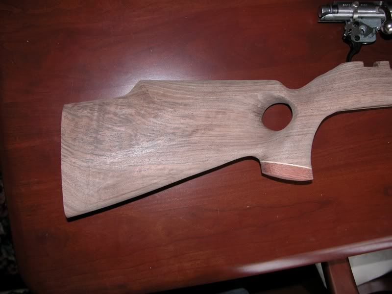

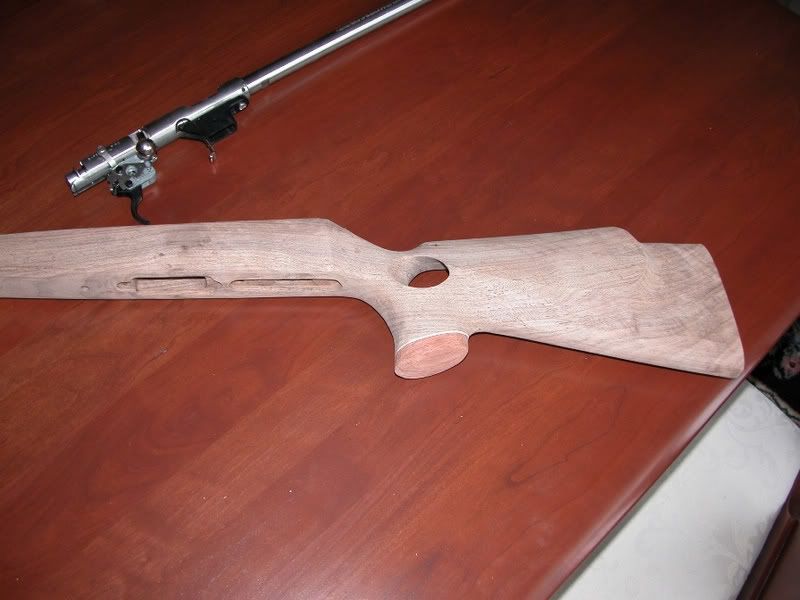

This is how it was right out of the box...
The marks you see in the second photo were the worst and all it took to erase them was some elbow grease and sandpaper.

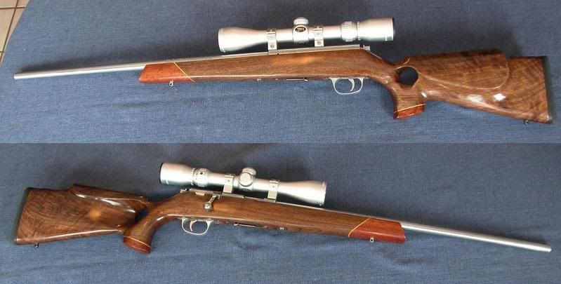

The rifle finished up like this
It really wasn't that bad. The inletting did need some work, but since I pillar and glass-bedded the rifle it was relatively easy. I think it all comes down to people's expectations... if you don't mind spending some time sanding, fitting, and finishing a stock, go with Richard's Microfit. They do have a ton of stock styles available for any of their inlets and wood types/grades. I haven't got any stocks from Boyd's but I suppose they finish theirs more than Richard's.
I finished the stock with many, many coats of Tru-oil and am working on fitting inletted sling studs and a checkered steel buttplate for a classy walnut/stainless rifle. Should be nice.

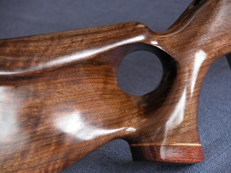

Semi-fancy claro walnut
,this was inbetween coats of Tru-oil so it's not well polished and the finish is uneven)

Nice wood, and nice work on the stock. It was very good to see your pictures.
