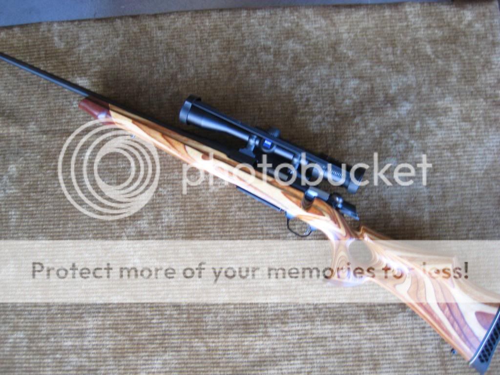

Very satisfied with my stock for a 300 WSM. Cost was $95 and it took many hours of happily working away in my workshop. The stock was a blank that I had to inlet myself. Love the rosewood snabel forened.
