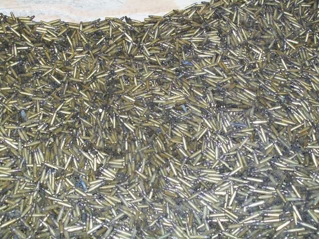

Our brass came in 6x6x6 boxes... that are 6 feet by 6 feet by 6 feet weighing over a half a ton (No lot numbers ;) ;) ;)).
And moved the cases with a forklift.
Between 2010 and 2012, I loaded 18 tons (36,000 pounds) of 223.
