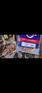

The accuracy was acceptable considering the condition of the bore. Those rifles had seen combat and poor maintenance during WW1 before having their chambers modified for the more powerful Swiss machine gun cartridge M-30 of the Solothurn MG in 8×56 RS.
The 8x56 has the .330 bore of the initial 8x50 cartridge whereas the 7.92×57 Mauser is a .323 (previous bore was .318) which is the most frequent standard for most 8mm ammo.
Importing .257 bullets from Serbia is a painstaking process as Serbia is not (yet) part of the European Union and is also an ally of Russia...
Thank you for appreciating my English. My late Dad was also a US citizen and despite being a war hero and the last living RAF frog Spitfire pilot, didn't have much consideration left for his former homeland (!).
