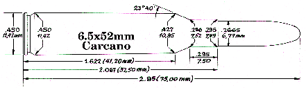

Just going by the print dimensions at the Web, you would get a pretty severe case expansion with the Carcano.
Primer would probably have severe blow by and fall right out on
opening the bolt.
I know it's been done by squeezing down .308 brass, but besides
having to machine the rim, the primer pocket would be in question.
