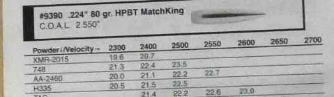

Here's an example of a Long Heavy bullet loaded long, per My Sierra manual.
