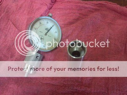

I made this gizmo for a good friend. Maybe he'll see this and post his thoughts. You simply drop the case into the fixture and set the indicator top on it, before and after sizing, to accurately check shoulder bump. Pretty slick tool!--Mike Ezell
Mike that is a slick little tool, out of curiosity, what would something like that set someone back?
I think I may have found the problem, the brass may be from separate lots, shouldn't be but I have an idea of how it may have gotten mixed up. If it did it would have been 18 pieces, I resized and checked them last night, 18 were tight as the dickens going in the chamber, 30 just fell right in and 2 were semi tight, so I don't know if there was a mix up or not. The barrel in on a competition gun and only has 150 firings with this brass so I'm leaning towards just using all new brass, have one more box of the old cardboard box stuff, might have to turn the necks on that tonight and call it a day.
I'd be happy to make you one...pm incoming--Mike

Mike made that bump gauge for me. It is the slickest thing since sliced bread. He put a lot of thought into making it easy to use and idiot proofing it.
I just de-prime the case, drop into the gauge chamber, and put the top on with the tip of the indicator on the same spot on the case head. Voila, you have a good, consistent measurement.
Mike's gauge was pretty much instrumental in isolating what was causing my inconsistent bump.
With the gauge, and a set of Skip's bump shims, you can get in the right ballpark without a lot of frustration.
