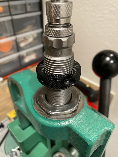

A click adjustable sizer from whidden would be ideal, but Forster not makes a lock ring with graduations on it, and I love it. The sharpie dot was installed by yours truly.
Nice, I'm using a Forster Coax so that probably wouldn't work for correct?
