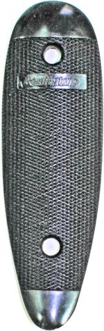

Not sure if butt plate is metal or plastic. Feels like metal.

Did you see the butt plate?
Well, that's because it's not a single shot stock. It's inletted for a long action ADL magazine box Model 700 Remington. Here's another dead giveaway clue that it's not from Remington. The only M700 based rifle that Remington made that didn't have any checkering on the stock (with the exception of the 788 which this stock isn't) was the Sportsman 78. The 78 was a M700 without any embellishments such as checkering or higher quality blueing. Those rifles were produced from 1978 to 1982. Even though it was a budget minded rifle, they all had sling swivel studs installed from Remington. The stock in question here has no studs. Nor does it have the same stock lines as the 78. I don't what the origin of this stocks is, but it certainly didn't come from Remington. One thing for sure is that it definitely isn't a 40X stock. If the eBay seller advertised it as a 40X stock it should be contested. Remington never made any long action 40X rifles.

Actually, not all of the 78 Sportsmans had sling studs installed.
Way back in the day I purchased a 78 in 243 Win and it did not have sling studs. It also had the later 700 style bolt handle.
