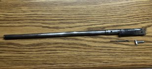

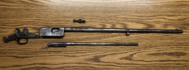

I’m wondering if some of you experts here can help me out. I was tasked with the job of cleaning up this ole Remington Model 12-A 22 pump and seeing if it will fire again. Well when I started the tear down I found the breech block is missing. I’m not familiar with this particular rifle and I’m not sure what else might be missing. I’m hoping someone here can look at these pictures and tell me if/what else it’s missing. It’s rough and I’m just trying to clean it up a bit and get it functional again. It was manufactured in 1919 so to breathe a little life into something that’s over a hundred years old would be awesome.IMG_0309.jpegIMG_0442.jpegIMG_0431.jpegIMG_0432.jpegIMG_0434.jpegIMG_0428.jpeg
Those were / are sweet little rifles. Numrich - gunpartscorp.com should have a schematic, but if I recall they
are hard to see, as they have their logo plastered over the page. https://stevespages.com shows a
Rem. 12 listing, but you have to join it to access it nowadays. Best of luck! Joe
