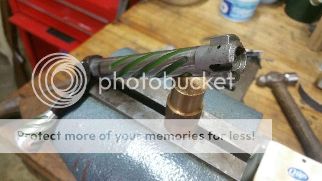

The flyer in the left hand corner of the cluster was a 70gr SMK not an 87gr VMax like the others. They were leftovers from my 10"t 6br.
The other big thing, the firing pin only has .125" lock time on the whole shebang. Standard factory Rem's have about .250". I was afraid that with .032" protrusion and .125" pin travel there wouldn't be enough force to detonate the primer, I was wrong. Even the 450's ignited without a hitch.
