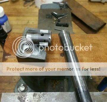

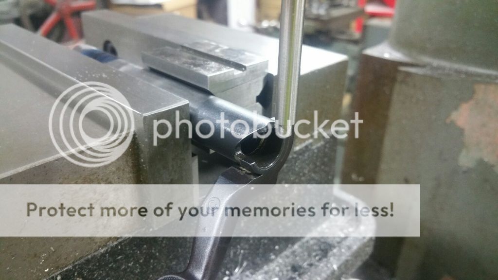

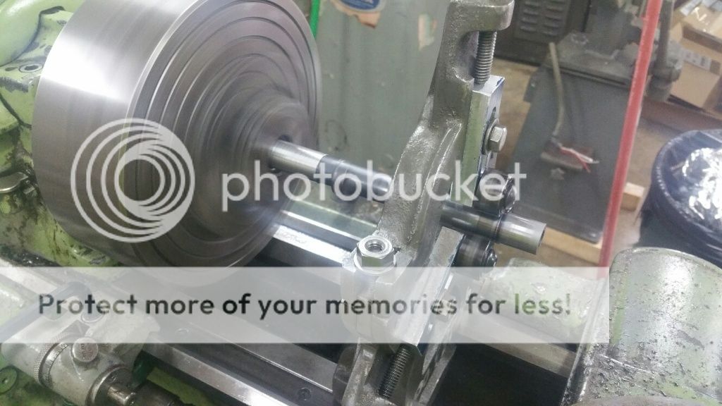

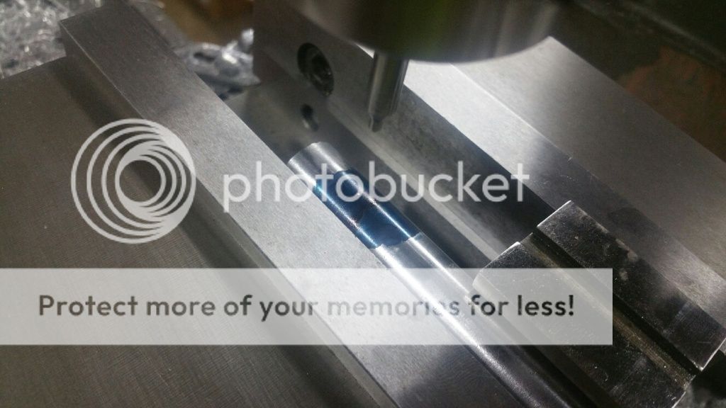

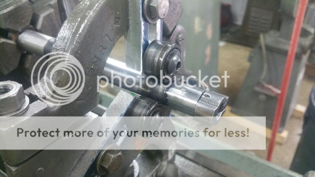

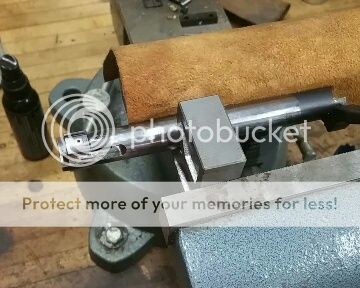

Thanks, I'll grind the firing pin this afternoon. It'll be nice to have a .062" pin again.

Looking good! You probably know this and have already dealt with it, but accurately timing the cross pin hole will keep it from "fighting" against itself when opening and closing the bolt..relative to to closing and extraction cams.
Also, it looks like you have chosen to go without using a baffle behind the lugs. The purpose of the baffle is to help prevent gas and other debris from coming at the shooter via the bolt lug raceway in the event of a case rupture. Using a baffle is not an absolute necessity but is a good safety feature IMHO. At the very least, I would use minimal bolt nose to barrel clearance as a means of metering gas and or debris from making its way out. Again, that's just my opinion..so take it for what it's worth. Several have been done both ways, including several customs, with no such baffle system. Personally, I think a properly set up Remington style "3 rings of steel" is the benchmark for gas containment designs. People often defeat that system with too much clearance at critical areas, without even knowing it. --Mike

Mike, yes this pin has -.0005" tension on it, best as i could measure it and it keeps tight in its hole. The baffles can still be added and probably will be added, but for the moment it was this or nothing. I run .005" nose clearance on BR style rifles, which this is.

I should have known, you know what you're doing. Some of the things I mentioned are overlooked, undervalued or just plain unknown to some pretty big names in the "gunsmithing" industry. Nice work, Adam! I'm more sure than ever that it'll be a job done right.--Mike
