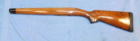

Here is my story on my Rem 722. I originally made an offer to a guy on what I thought was a Rem 788 in 222. My old brain was confused on models. The seller corrected my mistake & graciously rejected my offer. I was still interested because he offered me a really good deal if I'd take the 722 with the original stock that someone had messed up pretty bad. The butt had been sawed off an inch & the plate then screwed back on, for a kid I assume. The sling swivel holes were filled with some ugly mismatched beige colored putty. There were some other big gouges & holes in the forend which were also filled with the same ugly putty. To top things off, the barrel's front sight holes had been filled with solder.
A recoil pad fixed the LOP, an ebony forend tip & ebony grip cap fixed the gouges. I had the barrel cut & crowned at 24" to get rid of the soldered holes & provide a new crown. As per a standard for me, I pillar & glass bedded the stock. I refinished the stock with multi-coats of Tru-oil. I learned a lot from this project. BTW it shoots fantastic like a .222 should!
