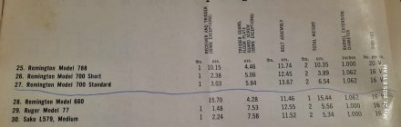

All REM 40X’s were short actions.
The 7 mm Mag and the 300 Win Mag I saw were built on Short actions.
You had to remove the bolt to remove a loaded round.
Hal

The early . 22 rimfire 40X’s were built on Remington 722 actions than they switched to the REM 700
actions. Again as far as I know all 40X’s used short actions.
A couple long action 40X’s are said to exist but I never have seen any or pictures of any.
