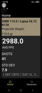

Ok.. so Im just about out of my CCI BR primers for my 30BR. I do have (by my standards) a nice cash of the Remington 7 1/2s.
From the fellows who have shot both how much of a decrease in velocity should I expect?
Right now I'm seeing an avg for 2988 on Berger 115s with 34.72g of N130.
Thanks guys!
Thanks guys!
