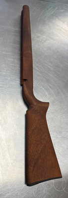

540x/xr in 541x , note the the second action screw is not used , modifications would be necessary to do this . [
ATTACH=full]1657332[/ATTACH]4399E971-81F8-400B-BB47-5D5F894F36C3.jpeg
