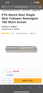

Im sure guys have done this in the past, so what are they using for a ramp?

For a single shot follower, the PTG one works well. It's contoured on the bottom to roughly follow the contour of the receiver. It can be epoxied into the receiver or held in place with a piece of foam from underneath if the stock has a magazine well cut. If the stock is solid, the follower can be epoxied into the stock so the receiver just drops over it. The Davidson/Sinclair versions are good ones too...they're flat on the bottom.
The Score High followers are designed to go on top of the factory follower and mag spring set up.
