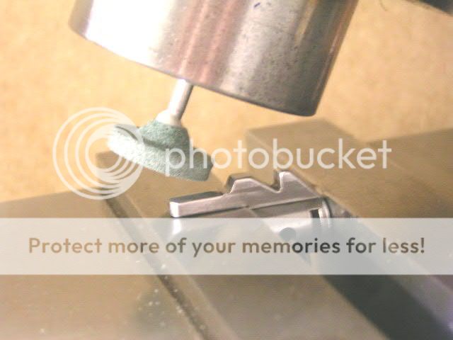

I cut down the full cock notch on all my rifles but I don't know if I really agree with this mod any more. Like anything, there are compromises. If you help the bolt lift you may be hurting the bolt closing. See first pic.
Second pic is adjusting the timing / firing pin fall. This action / trigger / bolt combo was terrible on bolt closing due to excessive firing pin fall. I think there is some recommended pin fall. .220" or something around there.
