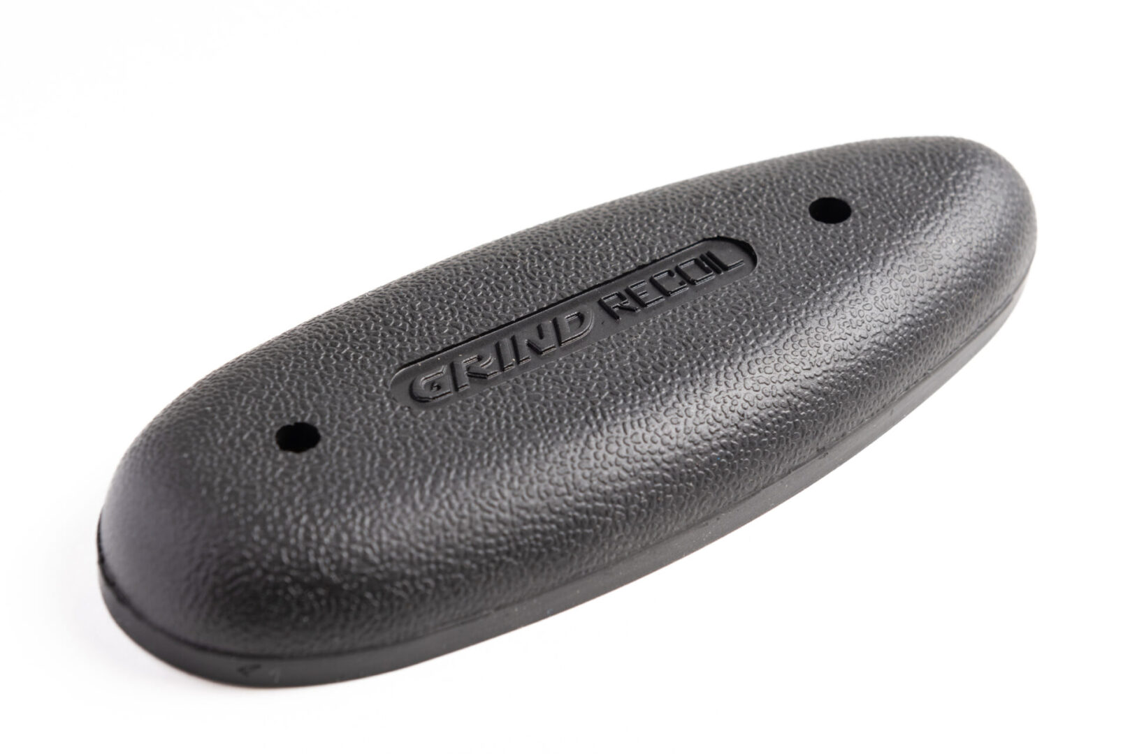

Al, I guess you know you are “officially old” when you fit a recoil pad on a 221 fireball. :)
Well, I've got to finish the back of it somehow. :D I've put a couple of these Grind Recoil units on. They're nice to work with and don't have a metal backing spacer to accidentally get into.Maybe I'll go retro and do a brown one.
