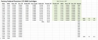

Yesterday, a shooter next to me was shooting Federal Premium Gold Medal 168 SMK's with his .308 AR-10 that had a 26" barrel. Being curious as to the velocity of this Federal ammo, he let me set my little Garmin on is shooting table while he fired 10 rounds to record. To my surprise, the average MV was 2709 fps (right where I my loads do well) with an SD of 8.4 and an ES of 25. That's way better than I ever used to get with Federal's best grade of ammo and looks like they might be doing better with quality control. Now I'm so curious, I feel like I'll have to retest this out of my gun to see if this might just be an adoration. :rolleyes:
Couldn't find a box of Federal Premium Gold Medal 168 SMK's, but got some 175 SMK's to run this test again. The 20 rounds of the box were all measured and the numbers recorded, then pulled the bullets from 10 of them, measured the powder and recharged the cases with the same powder but with each having the average (measure with FX-120i). BTW: the powder looked very much like the AR-Comp that I use and it's what I've heard that Federal is using in these Premium Gold Medal cartridges. Bullets were all reseated to what the average CBTO was for all 20. On the chart below you can see corresponding numbers prior to being modified. Velocities also correspond to the same cartridge data.
Like the test I did years ago, the redone cartridges performed better, though there wasn't as much difference as I had gotten then.
What I got on paper was better than the test I did before too, both for the factory cartridges and the reworked ones. See group info in picture below. In the pic below, the first two 5 shot groups was the untouched factory loads and the second two groups are the modified ones.
Note: while shooting the 3rd group, I was fighting my old eye as they were watering and making it really hard to a good focus. The first shot of that last group was so bad as I jerked the shot way left trying to get the shot off as I was blinking to clear my eyes for a clear focus. I got off the bench and took some time to clear my eyes before trying to finish the group. After taking some time for clearing my eyes, the next four shots were way better than I would have expected (a little luck helps too) ;).
