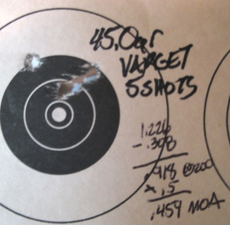

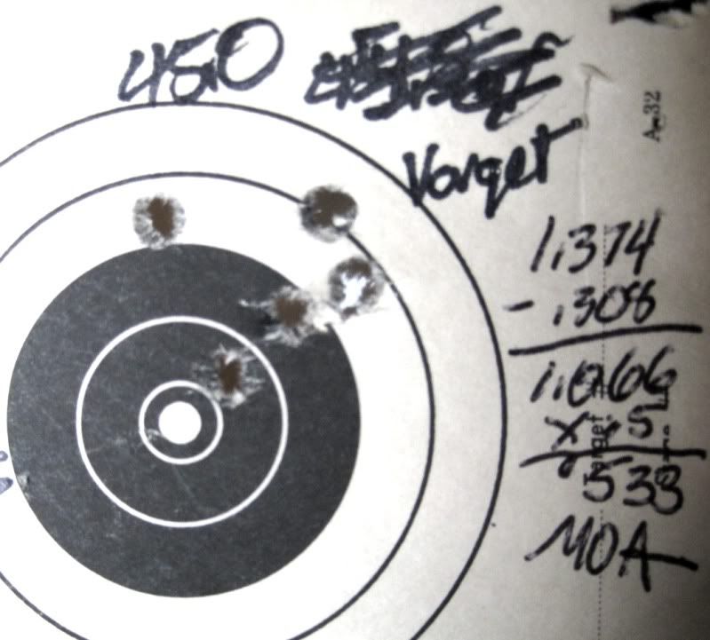

175SMK
unfired Lapua brass
45.0gr Varget
Federal GM210M Primer
2.888 COAL
2.3065 Ogive
.007 off the lands
Functions in Magazine
*Case Head showed ejector swipes* - Bolt lift tiny bit stiff
5 shots went .533 MOA @ 200 Yards
5 shots went .459 MOA @ 200 Yards
No chrono data this trip. Wanted to see if it was worth the effort. I know it's not the powder you asked about but I thought the results were pretty good. These worked in my rifle, they may not be safe in yours.
