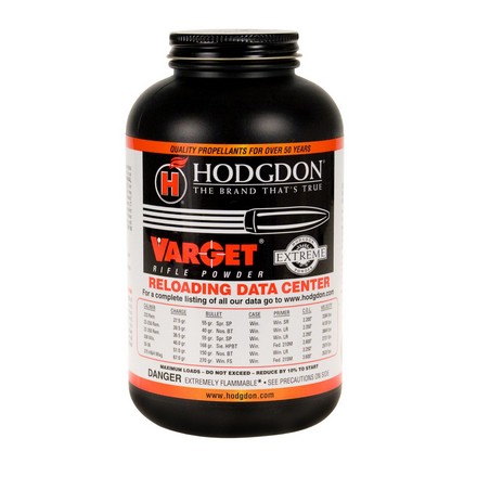

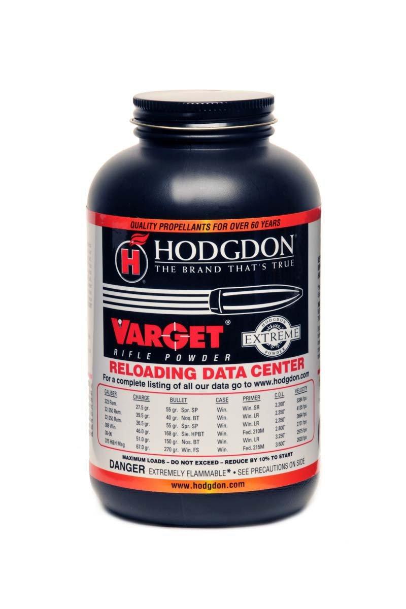

The popular Varget has been available lately, I'd recommend getting some and using it with your .308. Other good powders, if you don't already know, would be the likes of IMR-4064, AR-Comp, Vihtavuori N-150 or N530, Accurate 4064, Winchester 748 or StaBall Match . . . just to name a few.

There’s so many great powders for .308 but 4831 isn’t one of them IMO. Varget (my fav), IMR4064, RL15, N140, N540, Norma 203b (similar to RL 15), IMR 4895 and shooter world precision rifle (similar to varget) to name a few. Powder isn’t as hard to find as it was. I walked into Cabelas last weekend and they had a bunch including W296 which I picked up.

Was using H4895 a week or two ago. I’d probably favor that a hair more than Varget. Although Varget is far easier to find right now.

The very best .308 handloading article I've read in the last sixty years was in HANDLOADER magazine a number of years ago. The author did extensive testing with many bullets, but used only CCI-250 primers and Varget powder. I won't go in to great detail, but the article is worth reading for anyone with serious interest in handloding the .308 cartridge. Others on this forum will be familiar with the article and can easily locate it.
I've used Varget powder in the .308; it's a good powder but generally, I've seen slightly better accuracy with H4895 with bullet weights from 150 -180 grains, the only weights I can see as really worthwhile for the .308. While I've never tried any magnum primer in the .308, they will likely work fine if you begin your load develpment with them. CCI-200 standard primers have always worked so well for me, I've never seen a need to change.
