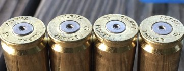

Picture of subtle increases of pressure. 33” barrel. Long bearing surface. I’d have to look, but the charge was not near max.
