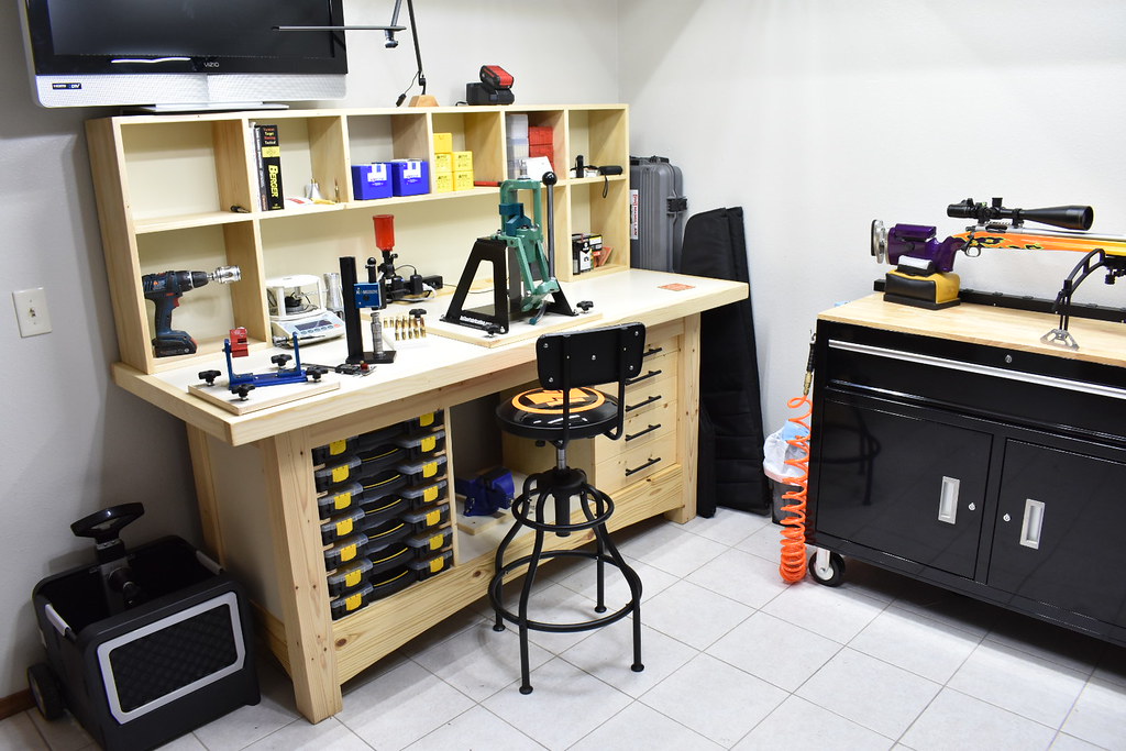

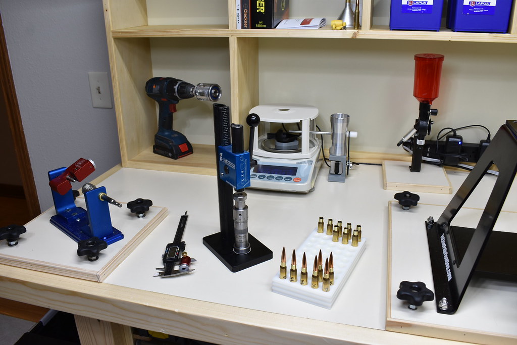

Great looking set up you have Terry. The bench came out really nice. I also like the metal storage tool chest usage. Can never have enough storage. One thing that I would be concerned about, I like the idea of compressed air, but those compressors are awfully noisy, especially in that metallic speaker box you have it mounted in.
Still a great setup. All you need now is a wall mount for your TV so that it is easier to watch. Maybe one that allows you to swivel and tilt for viewing.

Thanks. I actually bought a TV wall mount but not sure that I'm going to use it. It's really not bad at all in the present configuration. The compressor will be seldom used. I just wanted the ability to have air just in case I needed to blow something off or whatever. Believe it or not, it's actually much quieter in the cabinet than out although it is not quiet.

Very nice outcome! However, you still have tons of wall space to work with. I have the same "pancake" compressor for use on the loading tables, (3). Never knew I would use it so much cleaning the loading tables off. As my brother would say, "you done good".
Thanks. I figure the wall space will allow for plenty of further expansion once I determine what that should be.

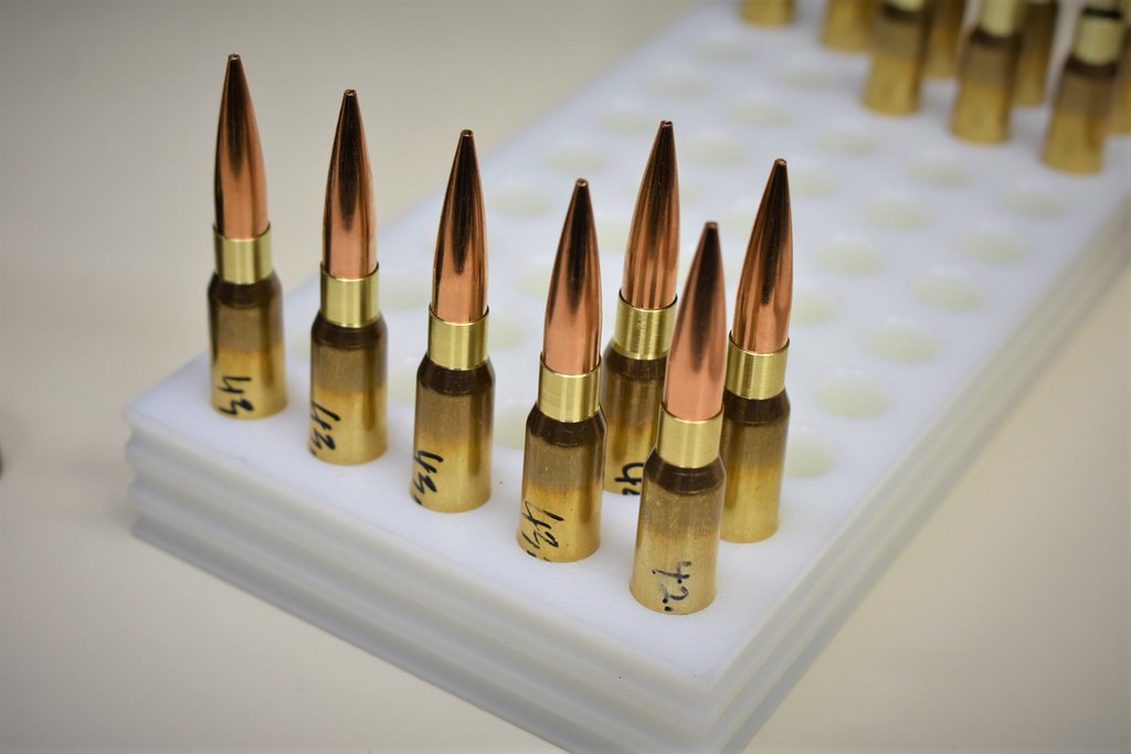

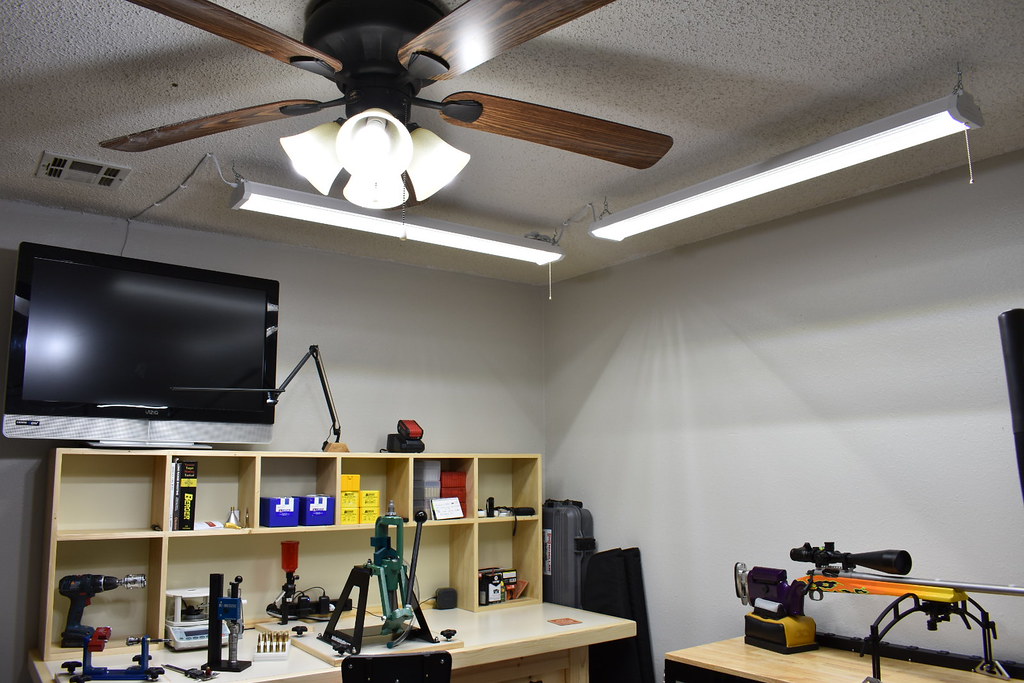

I finally got to make some rounds!!! 7 to be exact. Incremental pressure test coming up tomorrow. I also got the 4' led work lights up and changed the existing bulbs in the room to 17w led's. All 5000k led's in the gun room now. I can see!
I've very much enjoying the reloading room, bench and equipment. I was/am anxious to get going with the .308 F-TR rifle. I ended up loading rounds forthe pressure test from 42.5 to 45.0. I shot those over the weekend at my local indoor range. I will confess to be a fair weather shooter and 5 degrees is not fair in my book. lol...
Very minimal case expansion with .002 just above the extractor groove max. Bolt was free and smooth for all tested. Took some time to day to get 100 cases prepped and primed. Seems that somewhere between 43.4 and 44.0 seems to be the sweet spot for the 200.20x's, 30" barrel/FTR reamer combo so I'll start there and see what happens. Hopefully some better weather soon. Got 100 new Lapua cases prepped and primed today.
I am SO ready to do some ladder testing with this rifle!!

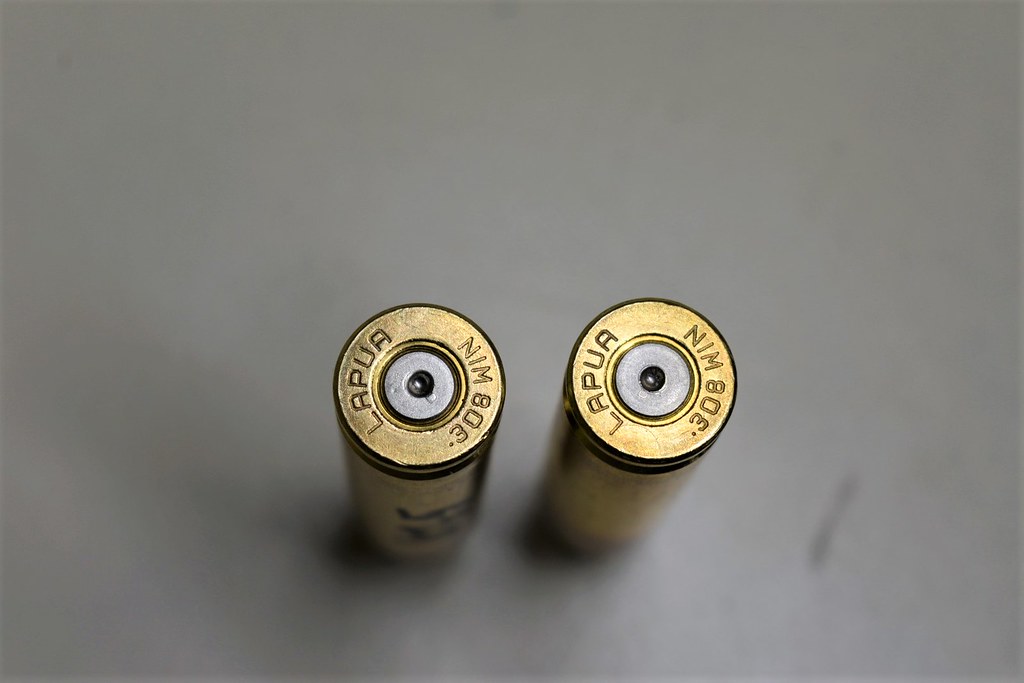

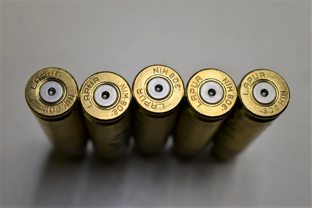

Lightest load on the left and hottest on the right. Thoughts?
The one on the left looks fine; the one on the right... the primer is *flat*, almost no radius left, and it looks like the beginnings of cratering on the primer. Definitely too hot.
Thank you.
