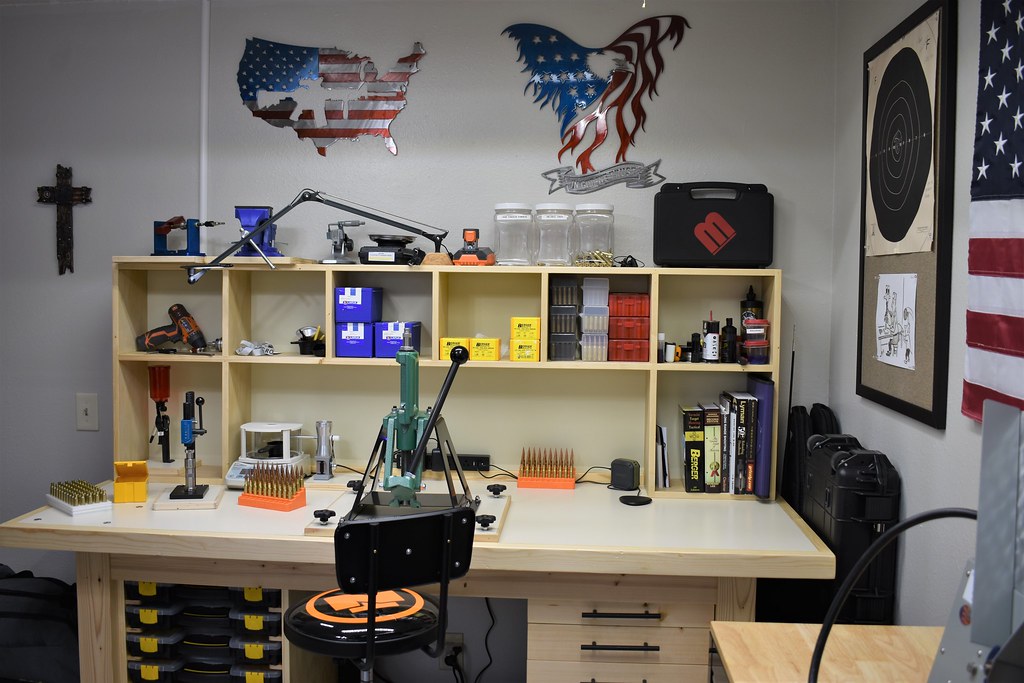

What’s causing that circular stamp-shape adjacent to FP depressions? In your first pic it’s at 5 o’clock on left, then 7 on right. 5-case pic has it moving from 11-9-9-4-12 L>R. I’d have some reservations over whether a bolt face defect could lead eventually to primer leakage.
Surprised you’re not using Palma brass, by now generally accepted to withstand repeated reloadings as well as moderately higher pressures w/o stretched primer pockets better.

I'll recheck the bolt face when I get back home. Did not see anything abnormal on initial inspection. I'll probably move to the Palma brass once what I have on hand is consumed. That's in the category of "if I knew then what I know now" I would have bought Palma from the start.

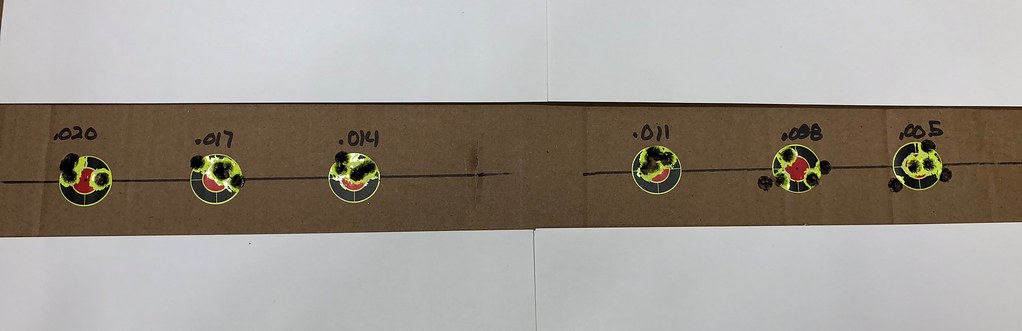

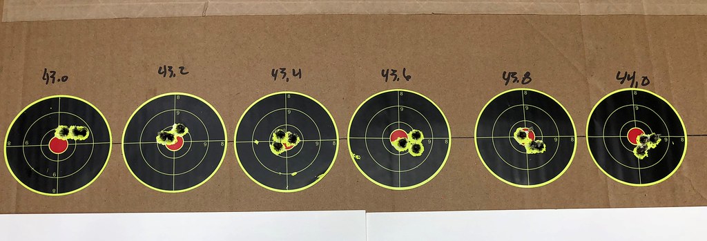

Couple of updates to the thread. First, I did find a nice load for the .308. I did the @Erik Cortina 100 yard load development and it worked out great. I bought a Magnetospeed V3 which I also love. Here's the results of the load and seating tests.
I ended up with 43.0 gr of Varget seating at .012 off. Shot 594 25x in my first 300 yard match including a 200 14x so I guess it worked out. :D

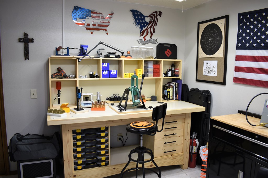

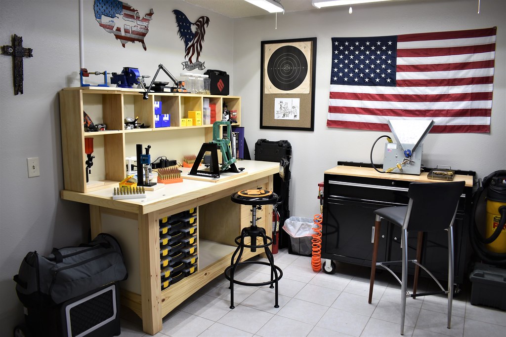

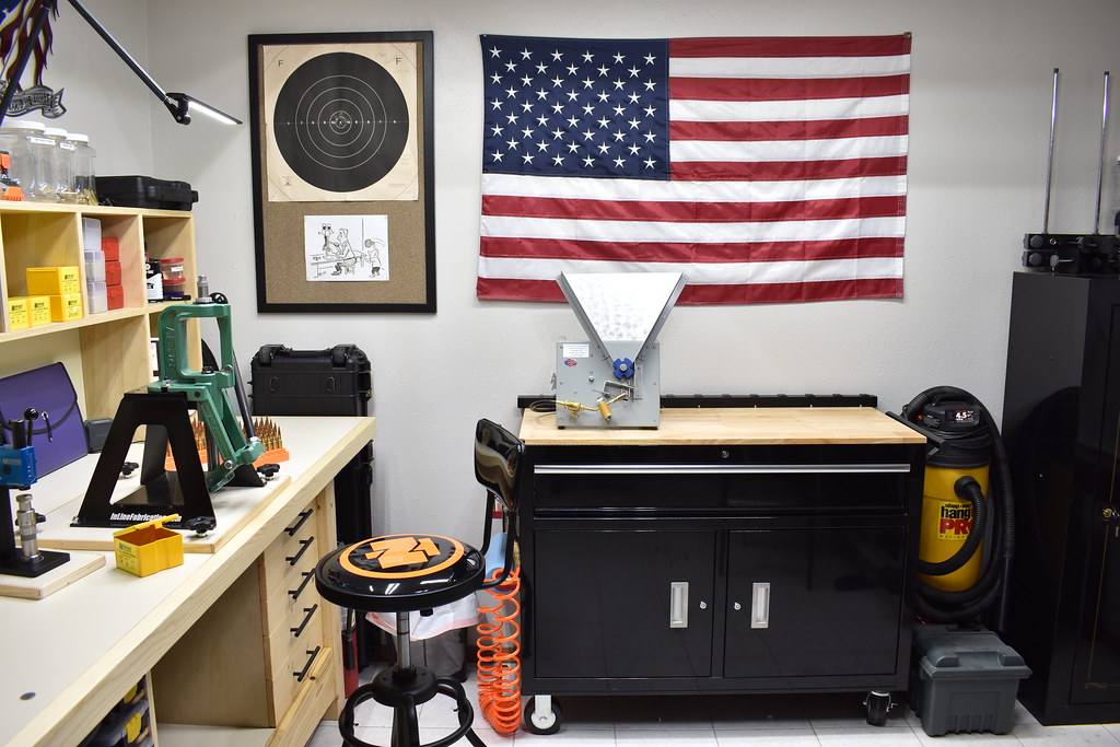

I've also continued to add to my reloading bench and room. I decided that I didn't want the TV in there so I took it out. I bought an American flag just to take up some wall space and that started a theme that I continue to add to. Bought a bulletin board to display the 200 14x target and whatever else ends up there. I also bought a used Giraud annealer I found in the classifieds here. This place never disappoints in spending my dollars. lol... Anyway, feel like I've got it pretty well set up now.
One of my favorite flag related things is this eagle that a friend made for me.
I also moved my old Hang Up Pro vac from my shop into the gun room. Very seldom used it in the shop but use it all the time in the gun room. It has a long hose that will reach virtually the entire room. Super handy.
The Giraud has wheels for the .308 and .223 cases. There was no back plate for the chute so I cut a piece of aluminum scrap and got that installed. I've ordered a regulator for the LP system because I can't ever leave anything alone. ;)
I'm sure it'll continue to evolve so I'll continue to update...

Congrats on the shooting, very nice for your first match. The room is looking fantastic. I love the Eagle Flag that you friend made for you. Keep up the reports, enjoy seeing your room develop.

Thank you sir! I'm enjoying working in and on the room very much.
:)Well done! Really well done! You need to add a lot more boxes of dies and bullets and such to give it that "lived in" look. That'll come in time. Get that fire extinguisher out of the corner and hang it by the door and please tell me where you bought that cool overhead light on the bench. LED?:):):):):):) Nice shooting, by the way!
