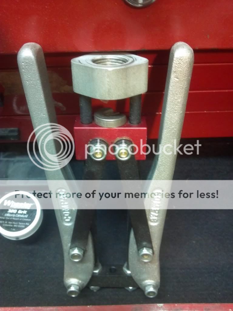

I use a Harrells compact press to do my seating depth at the range.

I take the whole kit to the range. For powder that needs to be weighed. I have a "wind box" for a tuned up balance scale. The box has a sliding glass front, and a trickler inside with the scale, with the knob that is used to meter powder sticking out through a closely fitted hole in the end of the box. With this, I can throw a light charge, and trickle up to final weight, just as I would at home. For larger cases I have a Harrell's turret press, or I can take my Rockchucker that has a Lock-N-Load conversion. With a set of wind flags, and my chronograph, I have what amounts to a portable ballistics lab. This allows very efficient load workups. I can get more done in a day, if the wind is good, than friends do in several weeks.
