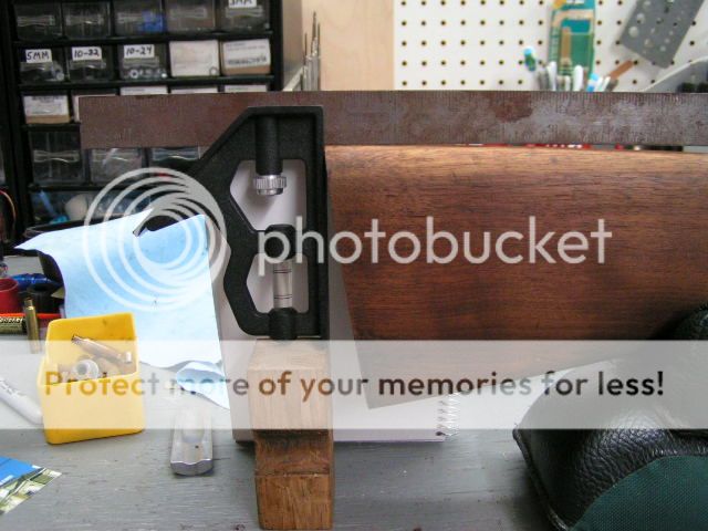

Every original 40x stock I have seen has been angle cut. There are plenty of sales ads floating around the web from the 1950's-1960's and clearly show the angle cut on the stock.
Here is my butt with a square sitting on top of the comb. At the toe of the stock there is just over 3/4" of gap to the square. Maybe mine isn't cut as much as I thought although it does look like more than the others. It's probably some angle that the AMU came up with. It does seem that in offhand it would rest on the shoulder with less likelihood of sliding off.

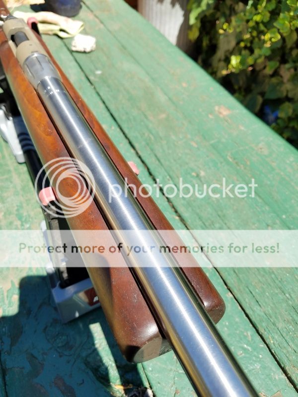

Finally got my 700 fitted to the 40XB stock today. In normal trim it should drop right in, but mine is a RemAge and Jewell trigger, so the barrel nut didn't fit in the channel and the Jewell needs lots of room in the well. Barrel is 26" Rem Varmint taper and fits the stock channel very well. It is fully floated all the way to the recoil lug. I also had to open that up as I have a .250" recoil lug that was snug in the slot.
Not a bad looking stock or rifle so far!

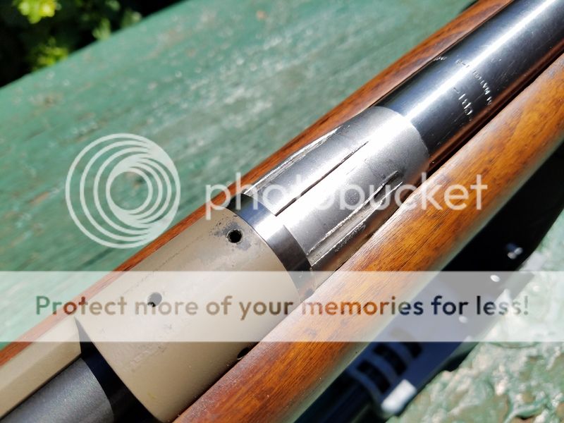

I use a PacNor bbl nut on my 40X rimfire so that I have a more consistent OD. I found that I could feel the torque shoulder location when slugging the bbl.
This is a pac-nor barrel nut, but the barrel channel stepped down from the receiver diameter right at the recoil lug.
Kind of coincidental that we're all sticking Pac-Nut barrels in these old stocks. Mine was Pac-Nor's #6 Sporter contour, which I had ordered before I got this stock. I didn't know what to expect as far as the barrel channel fit might be, and was pretty jazzed to find that it was damned near perfect. I opened it up a little in the nut area and first couple of inches, and my float is perfect.
I love this rifle now, and this old stock is a good part of the reason. jd
One cool unintended consequence of the PN nut on a rimfire is that you can adjust the headspace if you feel the need.

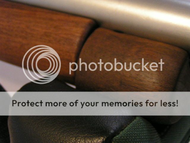

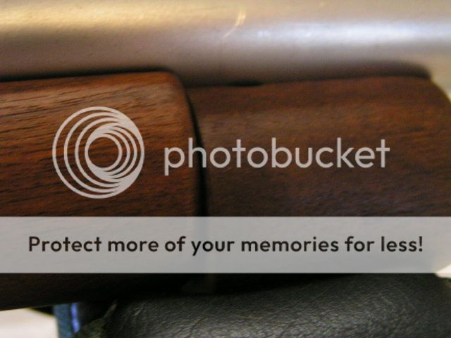

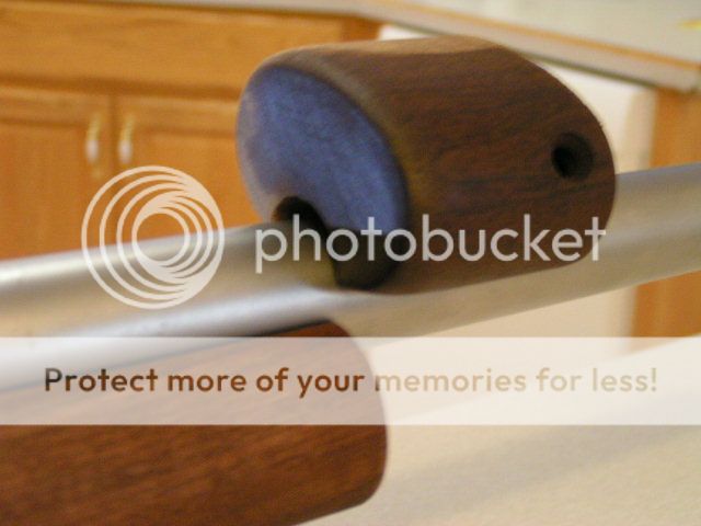

So I got the first coat of BLO on and have some observations about strippers. I cut off the first few inches of the stock to get rid of the "tuners". I took this cut off section and hit with with purple stuff as recommended. Then after it dried I lightly sanded it and hit 1/2 of it with 3 coats of BLO.
On the rest of the stock, once I was done with the inletting hit it with Citristrip and let it sit overnight. Then next day I scrapped off the old finish and then started sanding. I had to lower the upper surface at the receiver to eliminate some bad chunks missing. I used 80 grit for this and then went to 150-220-320-400 except I stopped at 320 :) .
The citristrip and extensive sanding made the stock come out much lighter and the grain was WAY more pronounced. The purple stuff strip job left the wood this dull greyish brown color. Then adding the BLO really brought out the grain of the stock whereas the BLO on the purple stuff tip did add color but not as pronounced.
