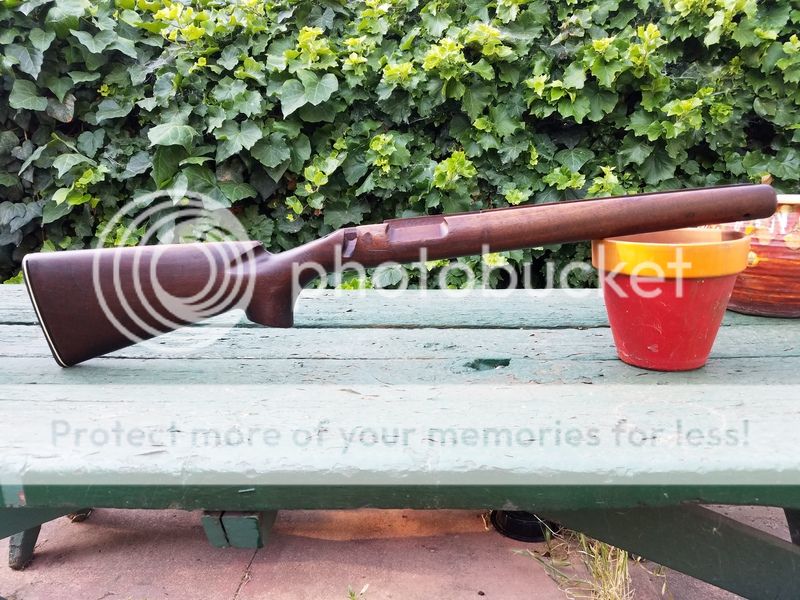

Here's what my 40x rimfire stock turned out like recently. The walnut in these stocks isn't real fancy, it's just real nice. I was very lucky on this one, as there was no damage that required any deep sanding or repair. Finish is boiled linseed only, no stain or anything else. jd

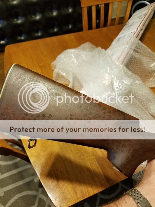

Got my stock yesterday and decided that rather than completely strip and refinish, that for right now I'll just refresh it. Lots of heavy grime and crud accumulated over the years on this one, so a quick scrub with Dawn and a scotch brite pad cut that all back. Wipedown with acetone to remove any and all traces of soap. Couple coats of BLO and it's looking good. This stock has lots of "character" but no major chunks or damage. Just plenty of little dings and scuffs. Looks good for now!

Here's the pics of the refresh I did on this stock.
As received, and the seller used bubblewrap directly against the stock...
After a scrub with dish soap and scotch brite pad...
Then after a couple coats of BLO to restore the lustre and protect the wood...
