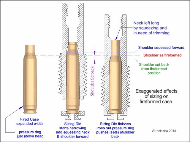

The only way something get longer is by pulling it
Just to help everyone understand what really happens during FL resizing. If the die isn't adjusted enough to move the shoulder back, it will move forward and get longer. I see it every time I first establish where my FL sizing die needs to be adjusted to. The drawing is courtesy of Unclenick form TFL forum.
