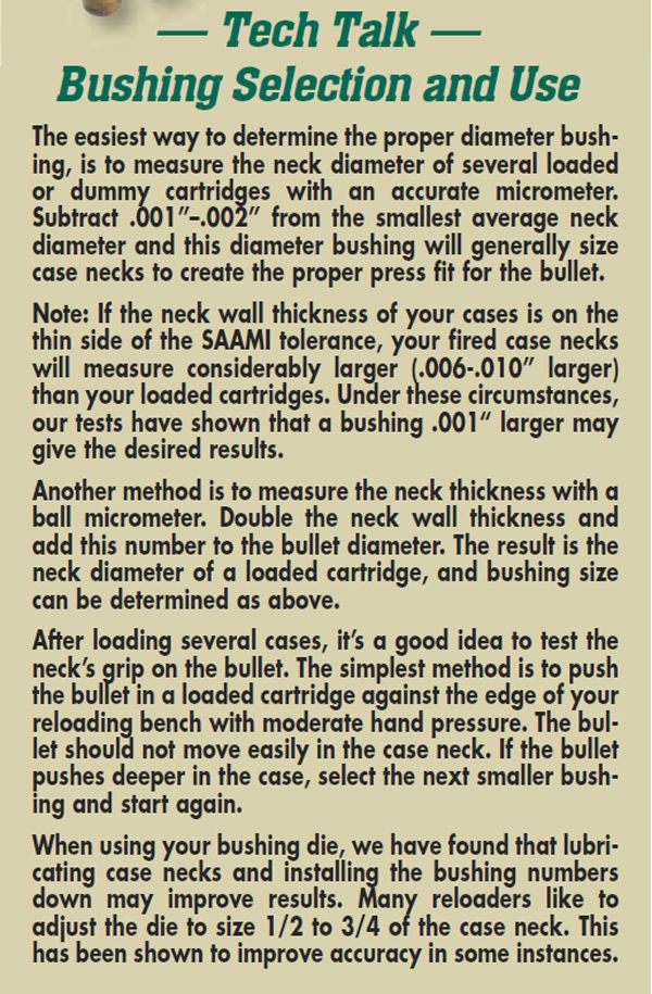

The bushing is not smaller than what they are marked. It is a problem when running a brass tube through a reducing orifice, adn the design of the bushings.
They mention it in a warning in their catalogue.

The first paragraph I did do. Loaded round =0.337-.002=0.335
Lapua brass is thick so I would not see a considerably larger than my loaded rounds.

read all of this , especially paragraph #7 . Jim
http://www.redding-reloading.com/tech-line-a-tips-faqs/140-bushing-selection

Bingo! It's right there in brown and white (as it were.)
There's another way to skin the cat - an inside out approach. Select a bushing using your dead reckoning based on loaded round diameter, etc. Size the neck. Measure the ID of the neck using a set of pin gages in an appropriate range of nearby sizes (class of gage tolerance chosen to suit you) to determine, within tolerance, what the actual ID of the neck is. Then choose a different bushing based on what you just measured.
Another way is to use trial and error: Size with a bushing which should leave the neck ID at bullet diameter. See if a bullet is a slip (not loose) fit in the neck. If it just fits, go down .001" or .002" or whatever. If the bullet will not enter the neck, it's likely to already be .001" or .002" smaller than the bullet. You could verify that by sizing a case with a .002" larger bushing. (Obviously a fair number of bushings, in increments, could be required for this exercise, and they ain't cheap.)
