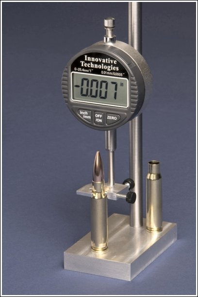

I've been a long time lurker on this forum, and I've found there's a lot of good shooters here. I just wanted to show you our new Digital Headspace Gauge. It's the easiest way to measure headspace, and it works on ANY caliber. It doesn't require special tools or bushings to operate.
