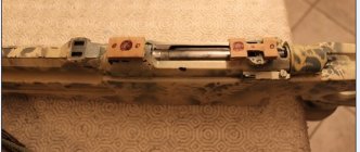

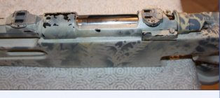

::)I would have another question: I have to build a custom rail to mount another scope without removing the welded bases that I have now(pic 1) and I wonder if there may be alignment or other problems letting the rings are too close together, (about 2,7 inches from center to center(pic 3-4), while now they are away about 5 inches; if there aren't problems, i can buy " Leupold qr gunmaker bases" and work on them(pic 2)or do you think that the Leupold rear base, so amended is too weak(pic 2)? otherwise i have to make the rail you can see in pictures and i have basically 2 options: to put the rear new base back(pic5) or front to back welded base(pic 3)
does anyone know if the type of welded base that you see in the picture is solid steel and can be drilled and tapped or if I have to drill even the action?
anyone has any other ideas?
i hope all this work can help me to obtain results as you can see in the last picture, with 308win and leupold scope vx3 8.5-25x40 (from top to bottom 800meters 155 a max 47grs vithavuori n135, 570meters 155 a max 46grs vithavuori n140, 570meters 155 a max 46grs vithavuori n135 : for my standards, a great day :-[
thank you
Partner, I don't know what you got going on here but remove the old bases, have a smith mount your new bases correctly!!! you will be pulling your hair out even moore then you have been if you cobble up some thing like that and try to shoot long range with it.
Wayne.
Sorry, honestly am a little confused, I always knew that the claw mounts was the best solution (apart from having to remove) and I remove it sorry, I want it, where reuse
http://www.eaw.de/en/products/claw-mounts.html
