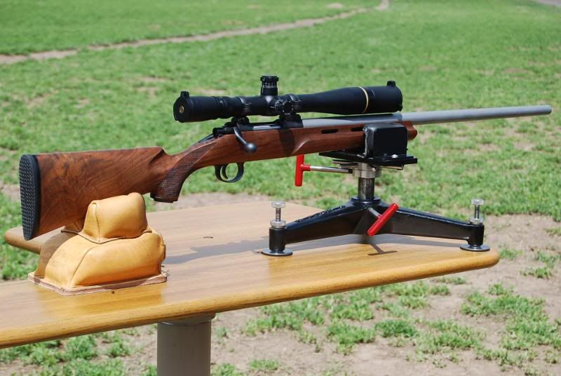

Like most others here, I've been through a few rests over the years, finally ending up with a Sinclair All-Purpose Front Rest. I don't compete either, just enjoy what I refer to as "BR Varmint Shooting" for ground squirrels and PD's.
This rest has an adjustable front bag with "squeeze plates" to adjust the forearm width from a light sporter rifle to a heavy BR rig with a 3" forend. The thing is all powder coated cast iron and stainless steel fittings/adjustments.

Yes, those tops/bags are adjustable from the narrow featherweight style hunting stocks all the way to 3" BR style fore-ends. However, you must set-up both front and rear rests to avoid any swivel studs from hitting the bags on recoil......I usually just remove my studs.
