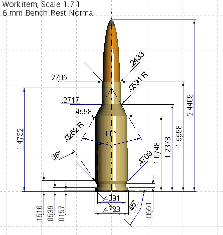

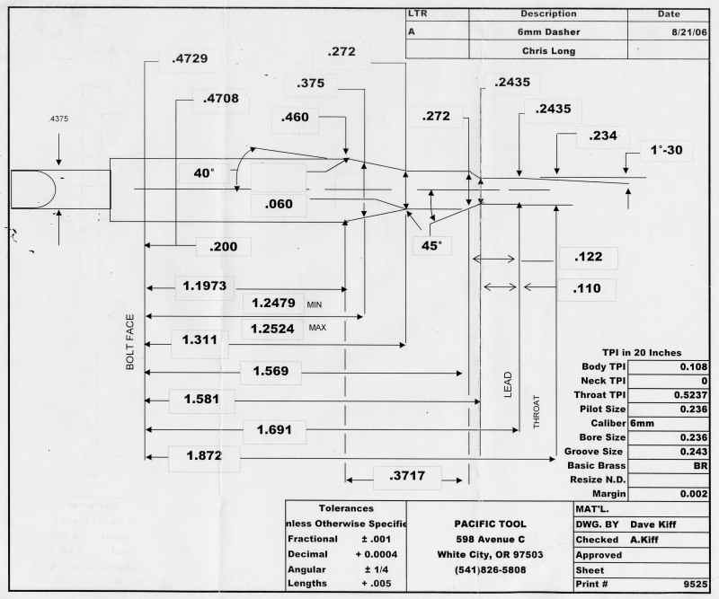

That is not the way Ackley suggested doing it. Look at the two drawings. 6MM BR vs. 6 Dasher. The two you used for comparison.
That evens makes it better . All mine was chambered for where factory brass and I never had to move the shoulder . But if you read The normal set back on a barrel is .004
The chamber is .004 deeper to get totally clean up. Just seat the bullet long and shoot it. Just like Ackley recomended . Larry
What page does it say than on, Larry? I have both books right here on the shelf.
I blow my brass out for both using the bullet jam method. When I don't the belted case I don't . When I chambered my 260 AI we put blue painter tape on the standard go guage for a reference on the head space guage
Ackley never a true specification . Because it was a wild cat
Dashers are the same . They now have a case that has a standard and brass will be head stamped dasher
