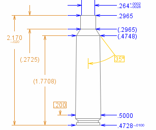

(Shoulder angle is estimated)
6.5x47mm Lapua
6.5mm-284 Norma
