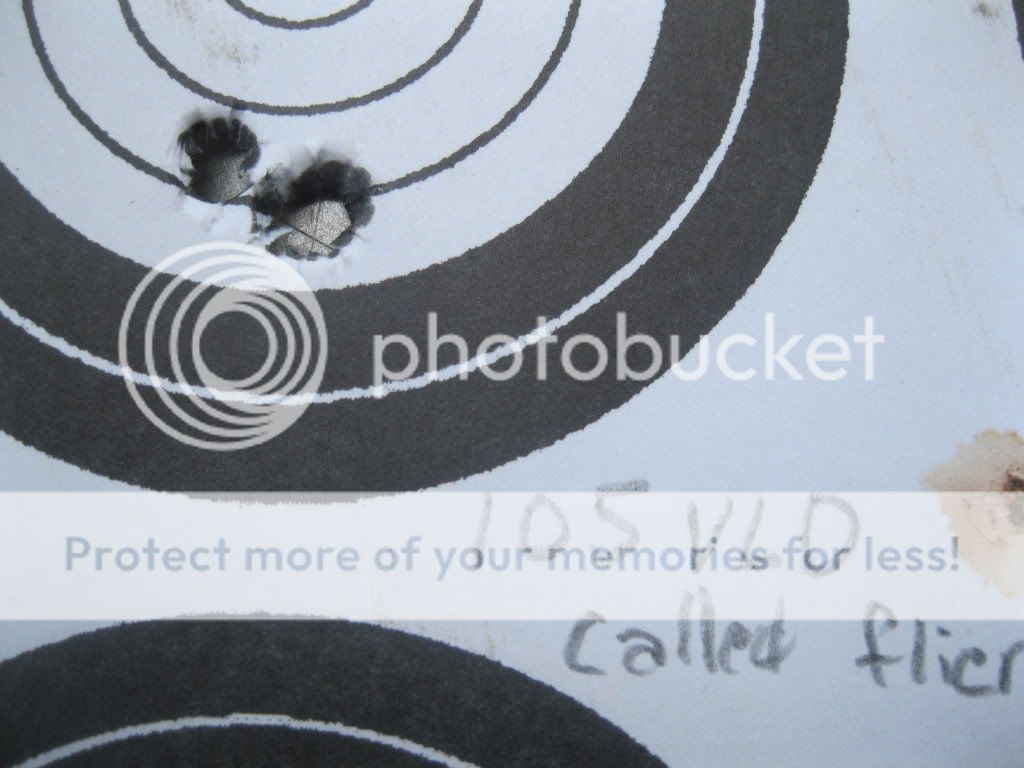

I took 3 bullet styles all charged with 32.5 gr RL15. The first one was terrible, I was concerned I had botched up the barrel, as nothing would come close to touch.
Next bullet was the 105 Hybrid, it clustered up nice, so I dropped down and carefully shot a 3 shot group.
Last but not least was my personal favorite the 105 VLD and the first two went together, but I had the rifle go off before I was ready on shot 3. I knew it was going to be bad, just not sure how bad, so I loaded another round and that dude went right down the middle with the first 2!!
