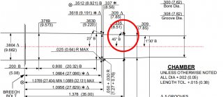

I rented a 300AAC BLK reamer from one of the "big two," I don't remember which right now. It was years ago, when the cartridge was newly SAAMI approved. I did two barrels. The reamer left a sharp edge where indicated in the attached image, where it should be a 45 degree chamfer. The chamber would actually scrape copper off a jacketed bullet which would build up and prevent chambering a round. Forget about lead bullets.
I verified this with a bore scope. No question about it. It appeared to be like a 90 degree shoulder, not a chamfer. Of course I was told I was nuts, that I was misinterpreting what was obviously a headspace or ammo problem. I know others had complained of the same issue, scraping lead or copper.
I fixed both of mine with a special made 45 degree chamfer tool. Not cheap but cheaper than scrapping two barrels.300fuchamber.jpg
I fixed both of mine with a special made 45 degree chamfer tool. Not cheap but cheaper than scrapping two barrels.View attachment 1487185
So they said you were nuts? That's unacceptable if it was truly ground that way. Did you take a pic? I'm curious how this turned out. Fred has been a respected gunsmith and expert in the trade for several decades. I'm not saying you were wrong or that they didn't screw the pooch somehow but someone else made that reamer or shapened it and they are wo caused the issue, even if it should never have gone out of 4d that way. I'm just curious because my experience with them has always been at the least, satisfactory. I do think that if you want to know the condition of the reamer, owning it is the best way and I've rented a couple that needed sharpened but they got the job done. Fred himself has always been responsive to any issues like that. I guess I lean toward understanding his side to a point because, as mentioned, no telling how the reamer was used by someone that knows little or nothing at all about bbl chambering. And yes, I'd say it's very likely that some have been abused to the point of having been chucked into a dewalt. All that said, they should be inspected and the idiot that screwed it up billed outlandishly for proper repairs. He offers a service that is nice to have when needed and he certainly knows how it SHOULD be but it may not always go as it should either. Nonetheless, they should all be inspected under magnification for any damage upon return and never sent out in poor condition. This should absolutely go without saying in that business. I would assume the worst until inspected, in his shoes.
Still, I think he would absolutely want to know of an issue like you had and have it remedied asap.

Well they didn't SAY I was nuts but it was implied I didn't know what I was talking about. Specifically what I was describing was "impossible." And I can't say it was 4D. It may well have been the other guys. I honestly do not remember, it's been so long. I have rented from both multiple times. The exchange took place via e-mail months AFTER I had used the reamer and returned it. It was actually my second chambering job(s), although I'm an experienced machinist. I'm not a gunsmith. The problem appeared after I began shooting the barrels.
I had contacted the firm more to alert them to a problem and never asked for any recompense. The end result was they insisted I was shaving lead or copper when seating bullets in the case. This was certainly not so. They asked if I was handloading. When I said yes, it was off to the races.
Anyway, learning experience. Water under the bridge. I just shared because I thought it may help the guy wo stated a similar problem here (not chambering rounds). I've rented again a few times from both places and always gotten good reamers (as far as I know :) ) in a timely manner. My issues have been with communications. Since the last one, I have decided no more renting and I buy them. it's just easier.
