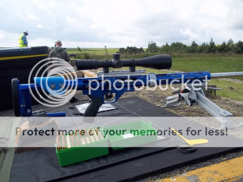

I hope I’m not taking this thread off topic, but I thought you might be interested in my latest 6.5x47 (we discussed my RPA a while ago).
Barnard P action, Bartlein barrel and the tube stock built by a friend and myself. Not finished yet as you can see, adjustable butt plate and cheek piece, should be complete in a couple of weeks.
Took it down to Bisley a couple of weeks ago and it shot 5” groups at 1000yds while fire forming new brass.
I think I’m going to like it ;)
Brian

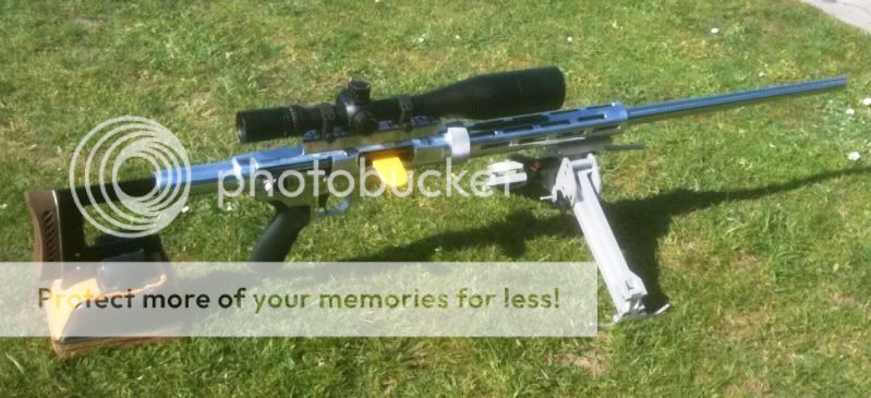

Hi Erik,
As promised here are some pictures of the (almost) finished rifle. Taken a while due to work commitments but very pleased with the outcome.
Brian

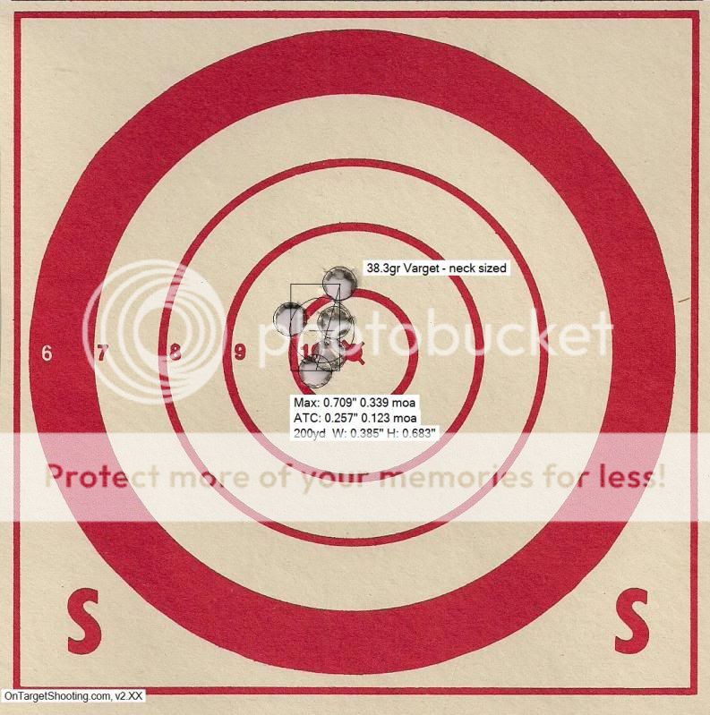

Not bad Erick, just starting with it.
Here is this mornings target:
Most of the targets had the same vertical spread in them, so a little work to do with either Varget/RL15 or RL17. (any suggestions welcome - rifle is chambered with the shorter freebore, 123gr SCENAR)
Neck sized by the way just means a light clean up to get the necks to a consistent .0125"
Brian
Erik,
Thanks, just checked that out with Quickload and it looks good - 3069fps and lower pressure than with Varget.
Will let you know how it goes.
Brian

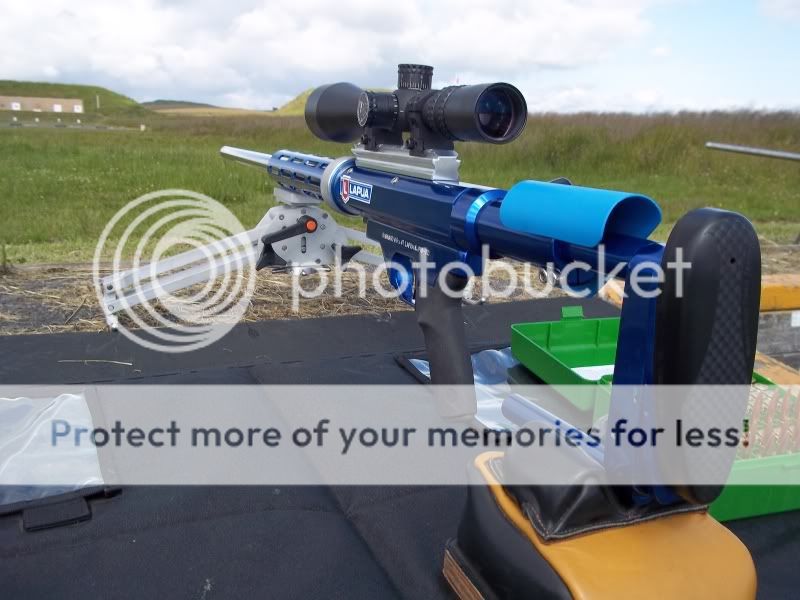

Just thought I’d post an update on how the tube gun is going.
I took it down to Bisley last weekend on the 1000yd range. I’ve been able to eradicate the vertical stringing. Neck tension was the problem. Although I’d lightly turned the neck of the cases to give a constant .0125” thickness I hadn’t annealed them. Twenty of the rounds I took with me were annealed to compare with non-annealed and all of them shot very well in light, 5 to 7mph left to right conditions.
Grouping for these rounds were all around the 3” area, I know this because the 3” square orange marker plume was full of holes. I handed the rifle over to a guy who is presently a serving sniper in the British Army and he hit the plume with all four shots of the annealed cases he fired. The smile on his face when he stood up was something to behold, he asked if he could take it to Afghanistan with him in November, but I said all that sand wouldn’t do it any good :)
38.3gr Varget
123gr SCENAR
2.692” COAL (.125” freebore)
.010” off lands
Going to try some N550 next as Erik suggested, if that would shoot as accurate, with a little less pressure, I’d be a very happy tube gun owner.
Brian
