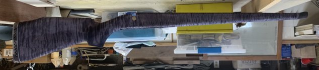

Bc’z is the high expert of finishing. No doubt about it. I’m not so I took a shortcut with the Aniline dyes. I applied a mix of dyes in alcohol to my maple stock after I sanded it to 1000. I explained it in the last few recent pages of my stock building thread.

you do some amazing work. this stock is awesome, are the stripes the natural wood?

and what is this one?! I really like this
I don't see much figure in that birch (it is relatively rare in birch). You're going to have a hard time getting the dye to show figure that isn't there. If you can add a little color to the arrow wood finish, I might just do that. Flamed abd tiger birch is a thing but it doesn't get used on gunstocks much because birch is a cheaper stock wood. It does oj savages and 10/22s. It's a great stock wood but usually pretty plain.
Those fancy dye jobs are done on wood that has figure, resulting from irregularities in the wood. They use dye because it doesn't soak into all the wood the same leaving darker and lighter spots.
Essentially you're highlighting blemishes like I did on this stock. It's easy to do but the wood has to have the right figure.
