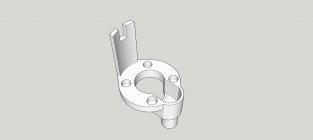

I've started designing a 3D printed RCBS Rebel Primer Catcher. Several versions of them can be found on: https://archive.org/details/thingiverse
I've observed the one on Etsy but don't like the design.
Most of my designs slide up and down on the press bar, which works well.
Using plastic tubing to support it against the bottom the press didn't work until I enlarged the throat, as noted in the right hand model.

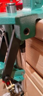

Robert740, if you add some magnets to your design (I am using 8x5mm earth magnets), the catcher will stay in place without any problems. Mine looks like this:RCBS_Rebel.jpg
Thanks Cecil!!
Robert740, if you add some magnets to your design (I am using 8x5mm earth magnets), the catcher will stay in place without any problems. Mine looks like this:View attachment 1479475
Interesting design! The fellow on Etsy had a similar design, but was having problems with the down tube cracking. How is your cross-sectional strength holding up? I tried using small magnets on an earlier design, but there must have been too much pull or the wrong magnets.
Never had a problem or heard about a problem from a customer. Nothing in that design is (as far as I know) a weak point - I rather invest into a sturdier design that requires a bit more plastic and costs a bit more, than trying to get the cheapest possible solution designed. Could be that it is not perfect, but again, nobody ever reached out to me to let me know and it works just fine on my personal Rebel.
