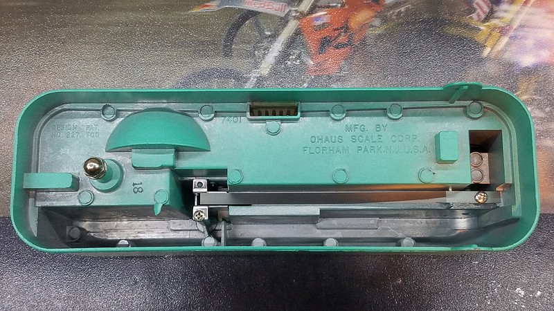

I picked up this OHaus 10-05 awhile back for a project, I’m trying to decide on a stone to sharpen these knife edges.
I’m thinking a small square ceramic stone from Brownells or maybe Arkansas, I’m open to suggestions.
I have numerous Spyderco ceramic stones, but I'm guessing the finish would clog them quickly and hamper the uniformity of the cut.
- Maybe a piece of thick glass or other very flat surface with a fine wet/dry sandpaper.
- Or wet knife sharpening diamond hone blocks?
- Or These diamond hones https://www.amazon.com/dp/B002RL83DQ/?tag=accuratescom-20
I use those EZ LAP hones all the time, they are priceless IMO.
For sure baby steps like tuning sear engagement.
Thx for the link
I was just at Harbor Freight yesterday, they might have had something had I’d thought about it.
Dang
Hopefully I can save this old timer
I can't think of the name of the stones but I would rather use a oil Stone that breaks down to material that you're working on.
You will not be removing much metal at all. I have done the ones that I did with a cheap diamond lap that started out life as coarse, but has seen such hard duty on various projects that if I were replacing it for scale use, I would choose fine. I do not really put any pressure on it, and I take care to do the same number of strokes on both sides of both edges. Do a little and test. Do a little more and test again. Use magnification to inspect your work as you go. If the scale does not repeat to zero, do a little more and retest. If it stops performing as it did, if it is clean, give it a very light touch up. Do NOT get in a hurry. If you are feeling impatient put it away.
Diamond cuts very fast so take care.
