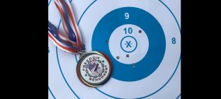

This is one of my customers. He lives in Florida. He has been doing quite well this last year shooting Freedom Benchrest matches. He's shooting my barrel with a nut, my Revolution stock, and a Kauger action.
He's shooting against some pretty spendy rigs.
I have a lot more medal pics from him from his wins.
