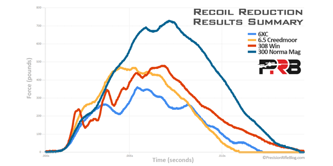

Here is everything you'd ever want to know about muzzle brakes.
