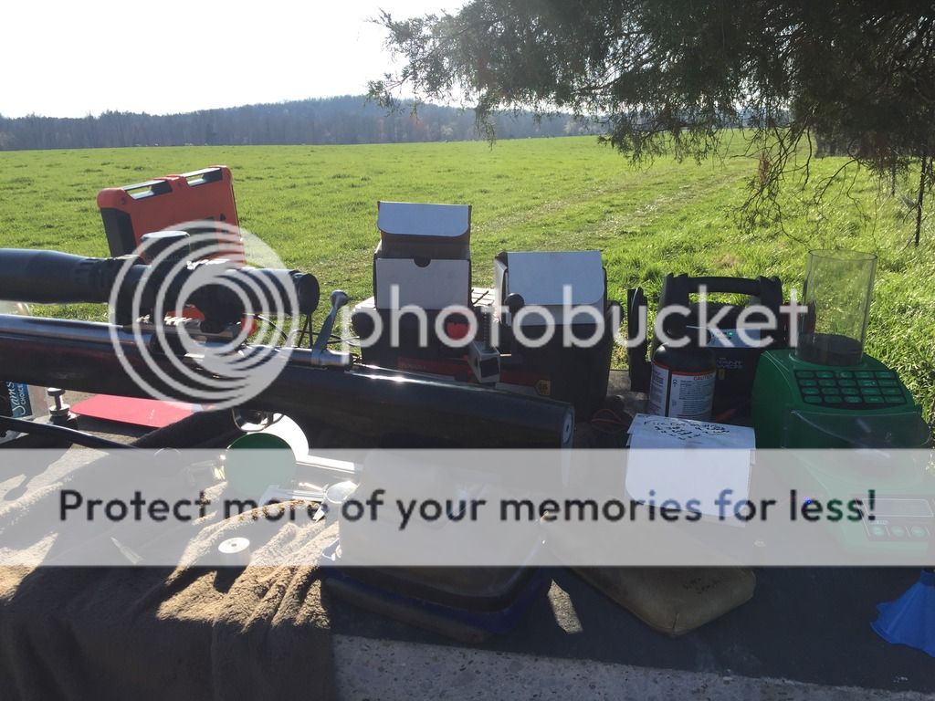

I put on a new barrel and tuned it at 100 and 200 yards for a day and a half. I had it shooting as good as I could get it at 100 yards. I'd say the gun was consistently shooting .200 3 shot groups or better.
I got in the truck and drove for 30 minutes to a friends farm that I can shoot at out to 700. My 100 yard tune was good for 3 inch 3 shot groups at 600.
I took 100 primed dasher cases and everything I needed to reload them on site. Within 10 minutes I had the gun shooting groups that were at or under an inch for 3 shots.
What did I change? Powder load and seating depth! It just took a little tweaking to get it to shoot. I used the labradar to makes sure the load was giving me the velocity range I wanted. After that it was just seating depth.

Today I wanted to try some more 22 Dasher testing with the Berger 80 VLD. I shot these at 100 yards with my Magneto Speed attached. Each group is .2 heavier charge. My first group was a 0 ES then the next .2 went up 11 fps and then you'll see the ES started dropping back off as the powder charge increased until the far right it jumped to a 20 fps ES, the bottom left I opted to jump powder charge by .5 grains and you will see again the ES drop back down to 3 fps but the group opened up. I contribute that because in the past I've found once you approach 3400 fps with the Berger 22 cal 80 VLD they just won't shoot well.
Tomorrow I'll take the groups that shot 9, 5, 2, and 20 ES to 600 yards and shoot five shots of each charge.
Powder is null as its not available to the public.
I'll post pics of groups from 600 yard test for comparison of today's 100 yard test
Not during but later on I chronoed them and each load was under 10 fps actually without looking back the 36.2 was like 5 fps Es
